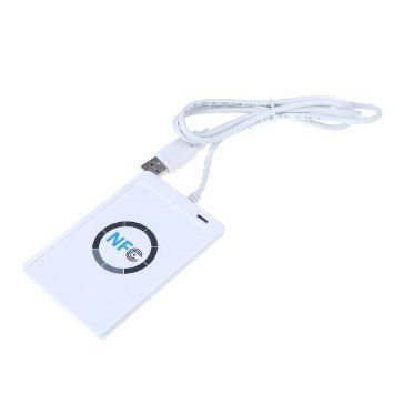

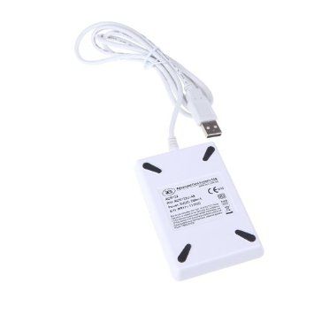

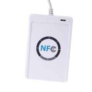

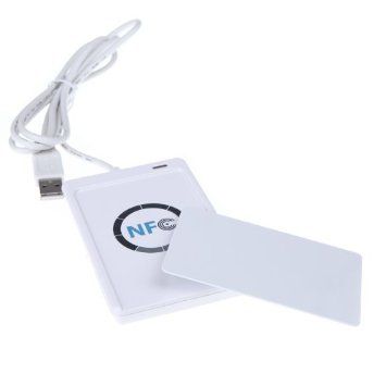

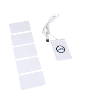

ACR122U Drivers (NFC)
The ACR122U NFC Reader is a PC-linked contactless smart card reader/writer developed based on the 13.56 MHz Contactless (RFID) Technology. Compliant with the ISO/IEC18092 standard for Near Field Communication (NFC), it supports not only Mifare and ISO 14443 A and B cards but also all four types of NFC tags.
ACR122U is compliant with both CCID and PC/SC. Thus, it is a plug-and-play USB device allowing interoperability with different devices and applications. With an access speed of up to 424 kbps and a full USB speed of up to 12 Mbps, ACR122U can also read and write more quickly and efficiently. The proximity operating distance of ACR122U is up to 5 cm, depending on the type of contactless tag in use.
The ACR122U NFC Reader is ideal for both secure personal identity verification and online micro-payment transactions. Other applications of the ACR122U include access control, e-payment, e-ticketing for events and mass transit, toll road fare collection and network authentication.
- CCID-compliant
- PC/SC-compliant
- Read/write speed up to 424 kbps
- Built-in antenna for contactless tag access, with card reading distance of up to 50 mm (depending on tag type)
- Supports ISO 14443 Type A and B, MIFARE, FeliCa, and all 4 types of NFC (ISO/IEC 18092) tags
- Built-in anti-collision feature (only 1 tag is accessed at any time)
- User-controllable bi-color LED
Dimensions 98 mm (L) x 65 mm (W) x 12.8 mm (H)
Weight 110 grams
Interface USB Full Speed
Operating Distance <= 50mm
Supply Voltage Regulated 5V DC
Supply Current 200mA (operating); 50mA (standby); 100mA (normal)
Operating Temperature 0-50°C
Operating Frequency 13.56 MHz
Standards/Certifications PC/SC, CCID, CE, FCC, VCCI, RoHS Compliant, USB Full Speed
